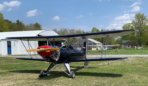

Believe it or not after 17 years (part time) of course my Classic is getting ready for Phase 1 flight testing. I'll get right to it. The trim handle is built to plans and operates very smoothly. My question/issue is about how well does the handle keep the trim in position during flight. Yes there is a knob to adjust tension but the surface area on the end of the trim handle axle is not great. I've put a wrench on the bolt and tightened the knob but I feel the aerodynamic forces will streamline the tab in flight or even cause a fluttering trim tab. At this point I am about to remove the knob and put a nyloc nut on the bolt to tension the handle. Have any Classic builders modified the trim handle to provide better friction to hold the trim handle and trim tab in a secure position?
Working on certification. First time complete aircraft saw the light of day.

Ours has been working well for 10 years. No slippage at all.

Congrats on your completion! Lookin real good! I am looking forward to seeing more pics!
